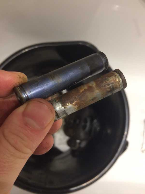

I have removed the drivers side caliper and taken it to bits and cleaned it up. From what I can tell the piston seems fine, no corrosion just a bit at the lip. One of the two tubes however that the long bolts run through is quite corroded on the end where the rubber sits (last pic), do I need to get 2 new ones of these are are they fine to re-use?
If all is ok, I'm going to kurust the caliper, give everything one last clean, paint the caliper and then assemble it all with new rubbers and red grease.

I'd change it, corrosion here is what causes the brakes to stick on, and it will only get worse, if you buy a pair you will have one for the other side.
Make sure you clean the seal groove out thoroughly, and take extra care fitting the dust boot.
According to the book, there is a knack to fitting it, it pushes all the way down the piston, and overhangs it, then you slip the flange into the retaining groove, and when you push the piston home, it expands the boot into the groove, and keeps it in place.
I thought there was a wire clip holding it in the bottom of am open bore, as there seems to be wire clips in the service kit.....

The pins certainly need replacing as they have started to corrode. It is imperative that these are free to move as they allow the one piston to allow both pads to operate. If seized or sticking then only the pad nearest the piston will work efficiently.
I take it the pictures of the piston are before and after cleaning. The after cleaning one is showing signs of corrosion in the seal groove!

That is just the dust seal groove, it could be many years before the corrosion reaches the working face.
The fluid seal is in the calliper, and should never get near that groove.
