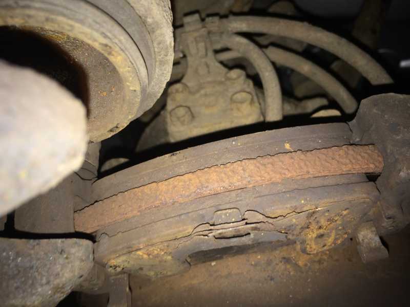

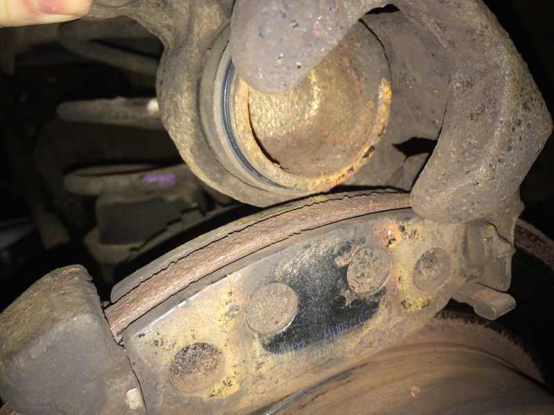

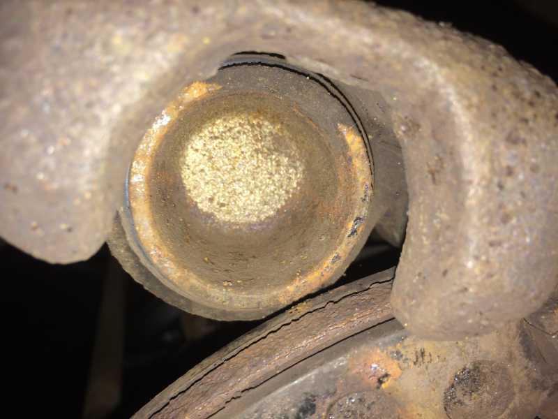

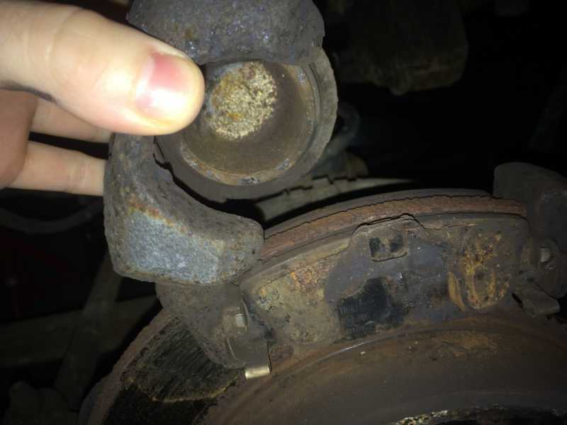

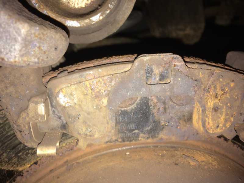

09 Dec 2015 16:28 #158177
by emu88
Replied by emu88 on topic Front brakes
I checked the caliper pistons today and when the brake was fully depressed the pistons on both sides weren't even far out enough to force the pads on to the discs if there was NO pad left. They came out maybe about 5-6mm. I then tried pushing them back with my hands, drivers side I managed to push back, drivers side I couldn't shift. Also the following photos show the pistons and related bits in a bit of a crappy state, worth cleaning pistons up and replacing rubber boots and grommets I'd say...?
