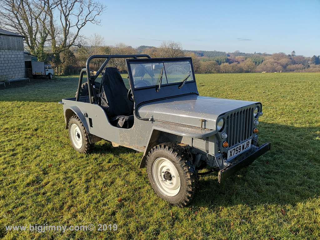

George has completed his Willys jeep build based on a Jimny and sent in these pictures as a conclusion. If you remember, this is the project built using a "new old" Jeep tub i.e. a brand new tub built to the original spec in one of the original Jeep factories. I think it looks really good.  The picture below shows where this all started.
