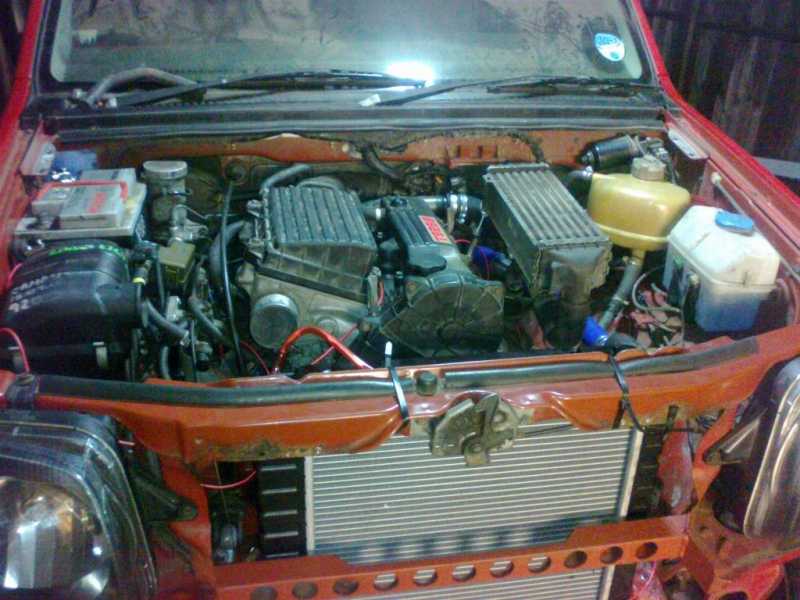

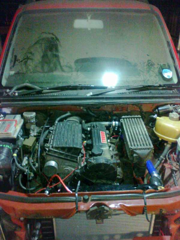

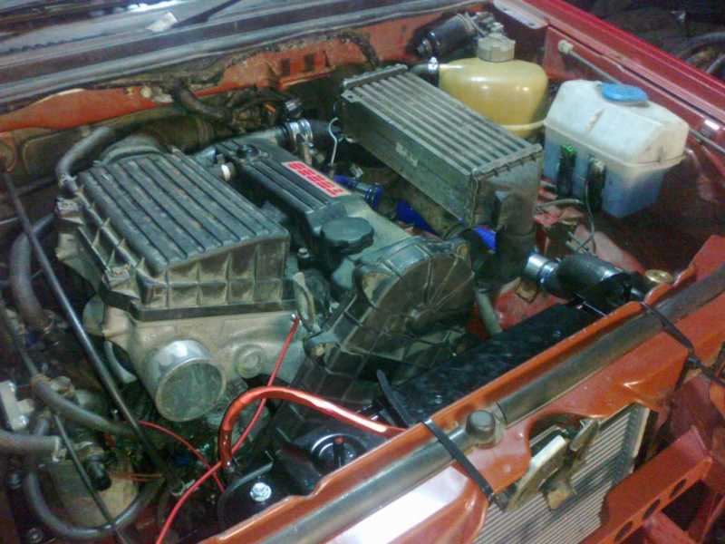

Well its all bolted up ready to go in tommorow with its new engine mounts so watch this space for all you Derv chasers
