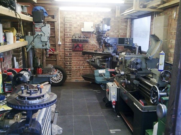

Yeah there just enought room for all the boost pipes and water pipes down the rear near the bulkhead! What radiator are you planning to use? presume you wil leave the ECU in so that you dash clocks etc will continue to work, i have the wiring colours if they are any help to you?
Nice workshop setup :)
