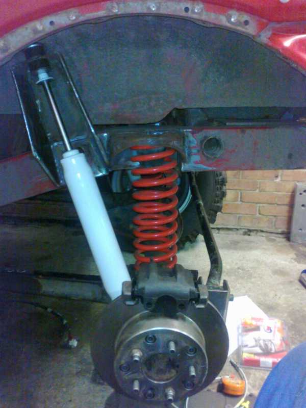

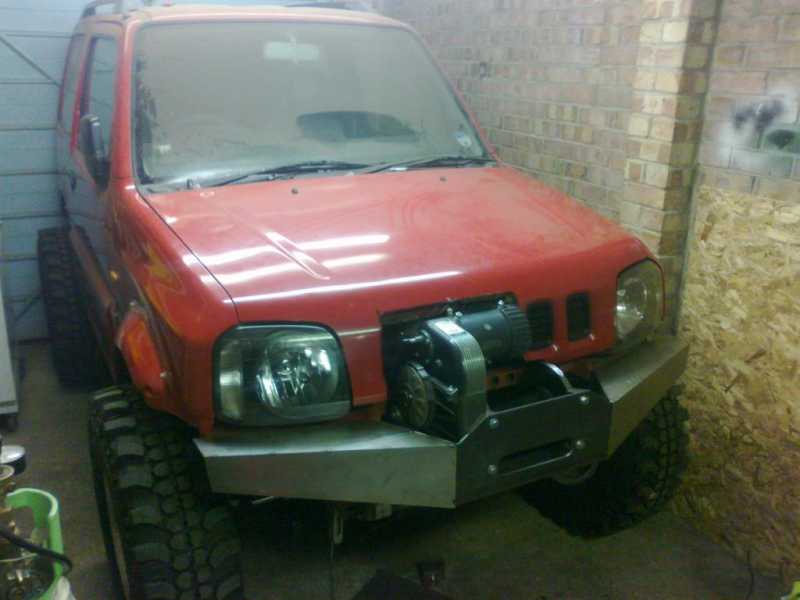

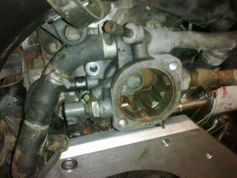

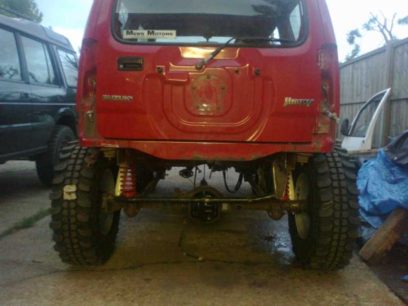

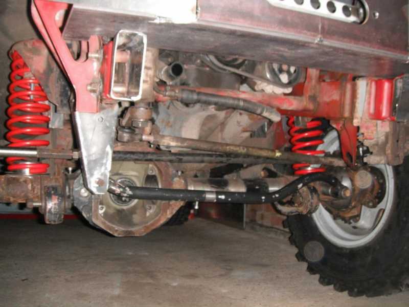

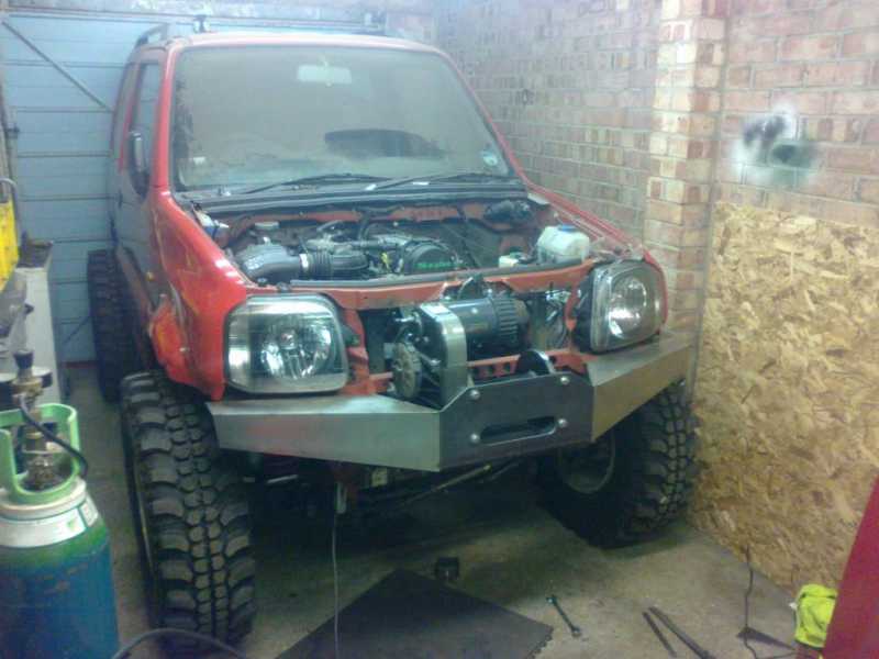

Thanks for the tip on the temp gauge drilled and tapped housing out tonight to take jimny sensor M14x1.5
Not sure if mine will ever see the road hopefully if i can get it through the test but really being built for winch challenge.
G wagon axles are bomb proof as they Dana style and running 4.99:1 CWP also come standard with cross axle diff locks.
Front axle centre diff housing has to be flipped as run contra rotating propshafts on a G wagon took me a day to do bit of a sod to say the least.
Got a rock lobster transfer box in low box 1st gear should give me 1mph per 1000rpm
Im on 33 Insas at the mo but may go bigger also running the G wagon hockey sticks KAP 4 inch lift springs with ES 9000 Challenge shocks pin pin type
Front and rear Winches champion 9000 in the arse and Gigglepin Warn 8274 up front hence 2 altenators

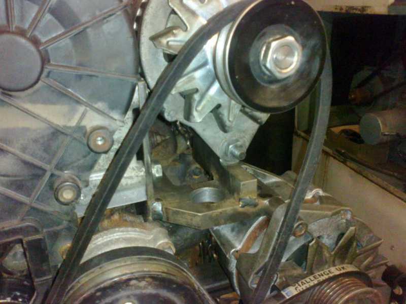

Very impressed with Jimny mate! I need to get myself some of those G wagon axles
What alternators are you using? They don't look the same as my standard one!
- Dave cc
01 Nov 2012 11:19 #51852
by Dave cc

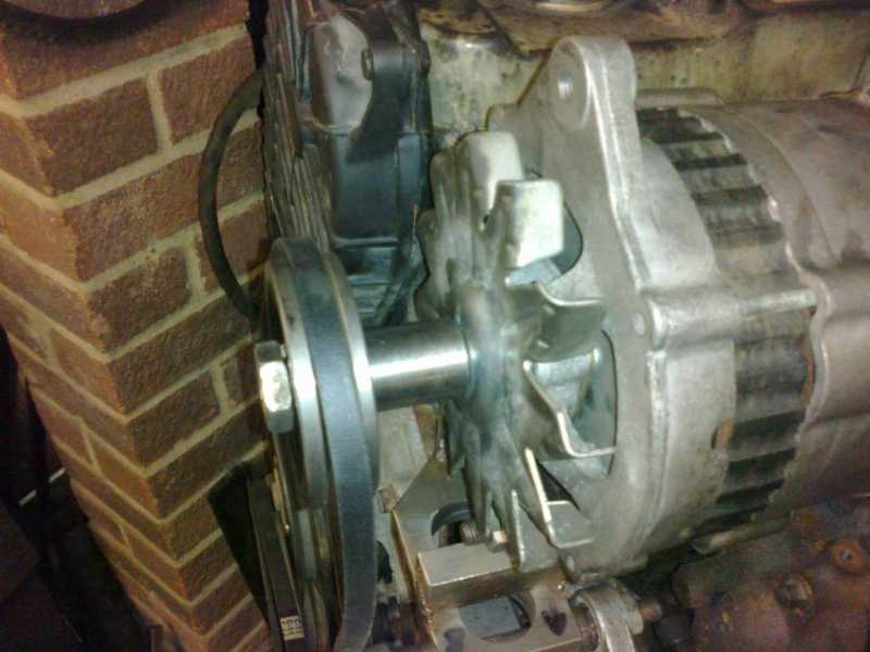

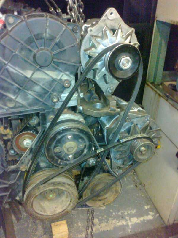

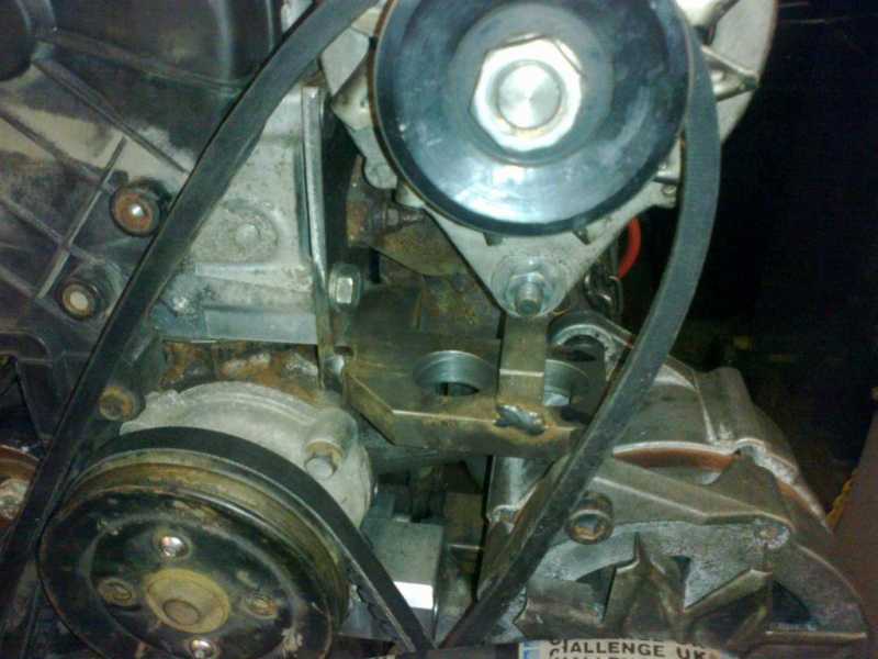

Replied by Dave cc on topic Isuzu 1.7 tdi to jimny gearbox
Top alternator is the standard GM Astra unit fitted with and extended shaft to allow me to move it backward s so it cleared the top hose outlet
Aux alternator is a Bosch unit Ex-Senator but fitted to a raft of different cars.
Thinking about rev counter issue think I will fit the Jimny cam sensor with a pick up disc onto the Isuzu camshaft leave the air temp sensor in place and Lambda sensor strapped up out of the way fit some resistors instead of the injectors water temp sensor now in place and just fool the ECU into thinking its seeing the petrol engine running Sounds like a plan to me but then WTF do I know lol
