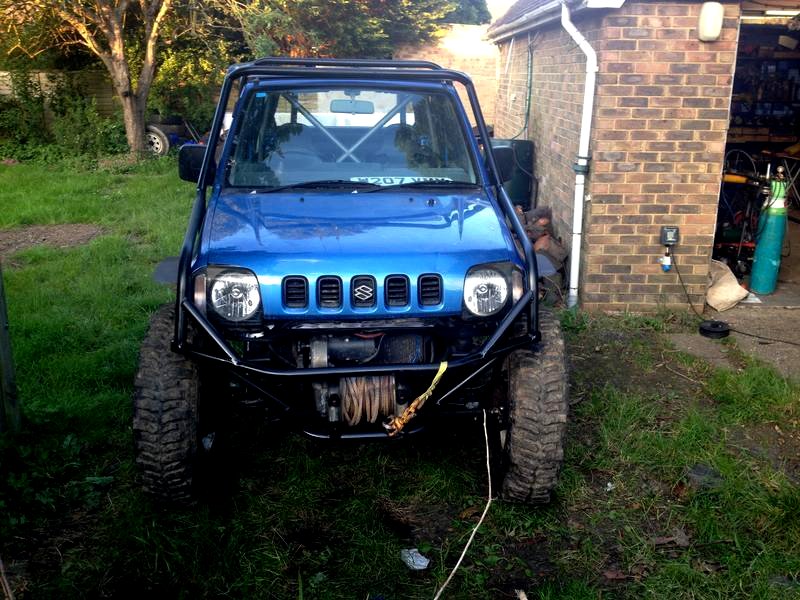

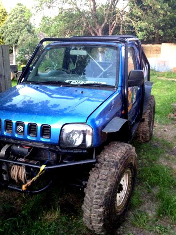

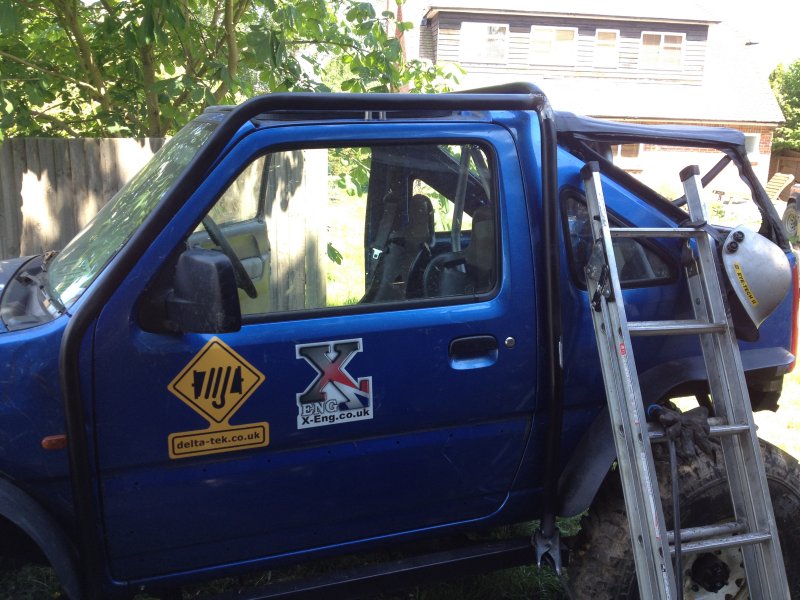

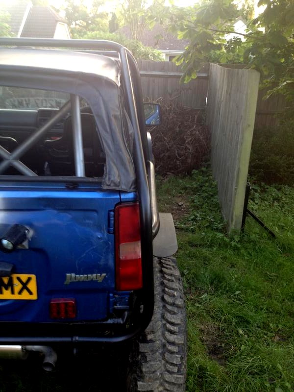

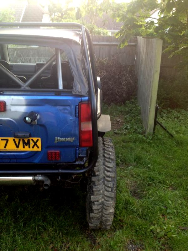

Well, I decided to find the time and make my own! Thanks for the input though chaps!
Not the best photos - they were snapped on my phone as it was starting to get dark.
It's not quite finished yet as there are still a few cross braces and the wing bars to add but I just ran out of time (and black paint).
I tried to keep it as close to the body as possible on the sides (it touches) but leave enough of a gap at the top to mount X-Lites front & rear. It could have been a bit closer to the top though, particularly at the corners. It sticks out rearwards of the corner lights a little more than I wanted - but it should protect the light housings OK.
I should add that the external cage is just to protect the body work (a bit). It has a full MSA Complaint internal cage as well to protect me!

Looks great IMO. How long did it take to fab up?

The external cage so far has taken about 8 hours - the rest of it has taken a fair bit more over the last year. Making the cage was interspersed with lots of cups of tea though!
