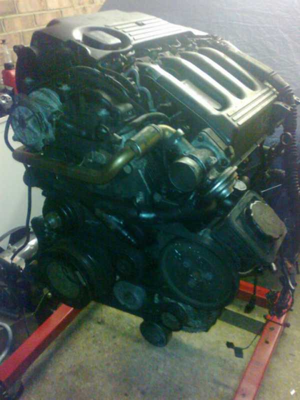

Dave cc wrote: Wonder if i could make this fit a Jimny gearbox lol
You wouldn't want to cos when that M47 needs a full decoke at 60k you'll wonder why you didn't put an Isuzu lump in. I'm an ex BMW tech and these are NOT a good motor!
  • Dave cc
15 Jan 2013 00:01 #58105 by Dave cc
Replied by Dave cc on topic Isuzu 1.7 tdi to jimny gearbox
Really well spotted as thats a M57 engine 3.0 litre diesel :laugh:
  • Dave cc
15 Jan 2013 00:07 #58107 by Dave cc
Sorry guys been damn busy getting G wagon axles back in place and wiring and plumbing aire to diff locks etc
Engine all in plumbed and running like a dream, glow plug relay wired and in place only thing left
to do is connect air intake to Jimny air box need some sort of swan neck hose so then will be able to use a standard Jimny Snorkel
  • darthloachie
15 Jan 2013 08:57 #58120 by darthloachie
Replied by darthloachie on topic Isuzu 1.7 tdi to jimny gearbox
nice B) bet it'll fly - should upset the V8 landie guys :lol: :lol:
  • JonnyJimny
15 Jan 2013 12:33 #58139 by JonnyJimny
Replied by JonnyJimny on topic Isuzu 1.7 tdi to jimny gearbox
Dave cc wrote: Really well spotted as thats a M57 engine 3.0 litre diesel :laugh:
Good point. Looked like a 4 on my iPhone! In that case there bullet proof.
