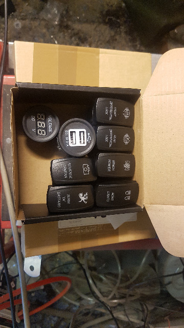

That reminds me, how do those pesky gen 4 blank buttons come out. Tried prising one out earlier, and it wouldnt budge. Maybe need some spinach i dunno.
So ive had a think, maybe ill just cut the spliced WACO 221 wire going to the winch, and add in a switch. If i buy some more cable i could run it up to the blanks. Thats as far as my noggin will go.

Andy I stand by my original comment, having a winch no matter how cleverly wired patched into an existing ignition live is less desirable than having it on it's own dedicated and separate circuit. If not there is a risk however small that something shorts out and does damage that could be avoided by it being isolated and manually energised, a winch doesn't need to be in standby constantly on a daily driver car. When you are going to need a winch you are going to know it in advance and can turn it on then. I'm not meaning to switch the big feed cables I simply mean to switch on and off the electronic control system instead of it being fired by the ignition tumbler every time you get in the car.

I'm with Lambert
My entire switching panel runs direct from battery (with isolation key switch)
Overkill with 30 amp wire 10 amp fuse next to battery
