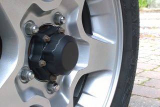

I've just lay down outside whilst the gf drives car forward. Front prop shaft is definately turning

Lol you all must think I'm thick as anything. I will have to get some hex sockets as have none lol!

Yes I just do surgical nursing now but was a specialist in Intensive care for 15 years and a transplant coordinator speaking to families of deceased and getting organs. It made me Ill with stress eventually. I love mechanics. This us just so frustrating. I will drive to garage tomorrow in my nice honda civic . I will ask if i can borriw his hex keys and then get it down there. I really thought once joining tubes up it would fix it but no!!

This is the confusing thing. The vacuum is used to pull the hubs in to lock them. If you have a split hose in the vacuum system the hubs would not lock as it would suck the air from atmosphere via the break/split hose. So in theory they should not be locked. Just as a side note, It does have vacuum hubs and not manual??
