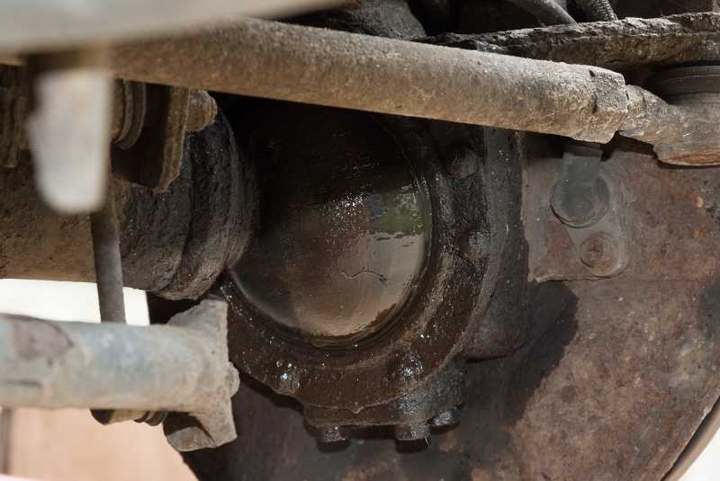

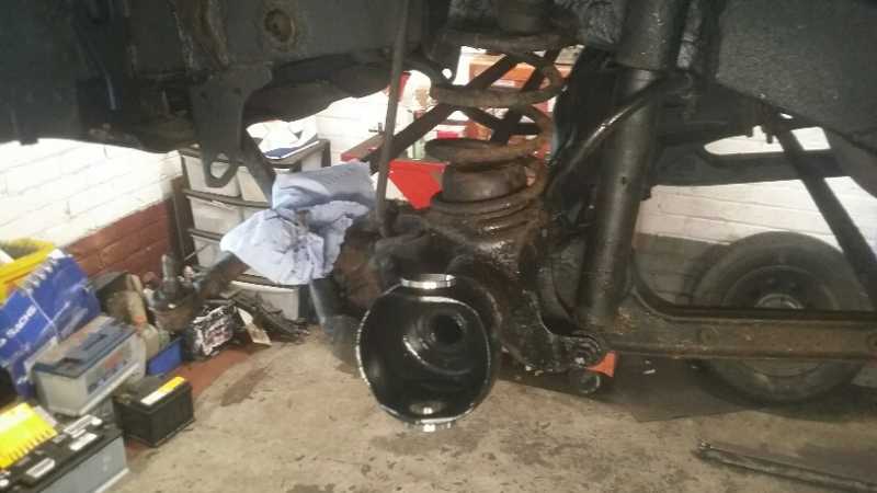

The local garage doing this job for me has sent me two photographs today to highlight their concerns at corrosion. Not knowing anything about Jimny's it looks quite bad to me but do I need to get a new part immediately or is it a non critical issue.
Advice appreciated.
Paul

Mine wasn't quite as bad but still had some rust on it. I just sanded it smooth. I don't think it's a massive problem as long as the pitted surface isn't where the oil seal needs to 'seal' or the where there is movement. This guide shows how it's all put together
www.bigjimny.com/mediawiki/index.php/Kingpin_Bearing_Change
27 May 2016 20:38 - 27 May 2016 20:40 #167610
by Busta
That looks pretty normal. Rusty swivels on a Jimny are not a problem and you won't improve anything by replacing the axle housing because they were never designed to be water tight, even when new. If you're desperate to 'fix' it I'd suggest filling it with some epoxy type stuff and sanding it smooth is a much more economical 'repair'.

Paul4A wrote: The local garage doing this job for me has sent me two photographs today to highlight their concerns at corrosion. Not knowing anything about Jimny's it looks quite bad to me but do I need to get a new part immediately or is it a non critical issue.
Advice appreciated.
Paul

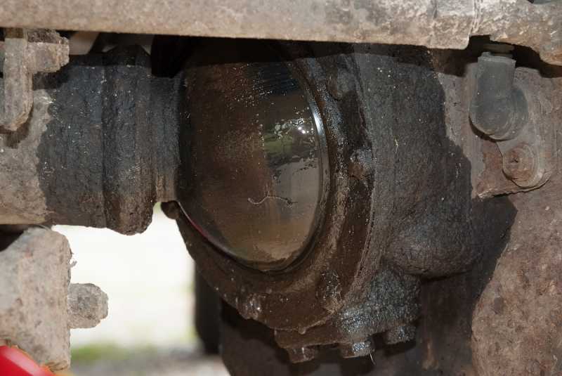

was just about to post for advice about a leak from the front nearside when I found this topic.
After wiping away the sludge, gunk and grime I found the same problem.
Do I need an extensive tool kit to perform the repair and how long would you estimate a job like this would take for one person (non mechanic) on the driveway without ramps?
These are the two pics of the problem which look identical to those already posted.
Any additional advice is most welcomed.
Slippy.
