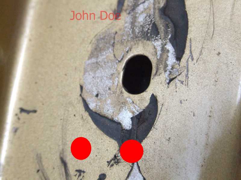

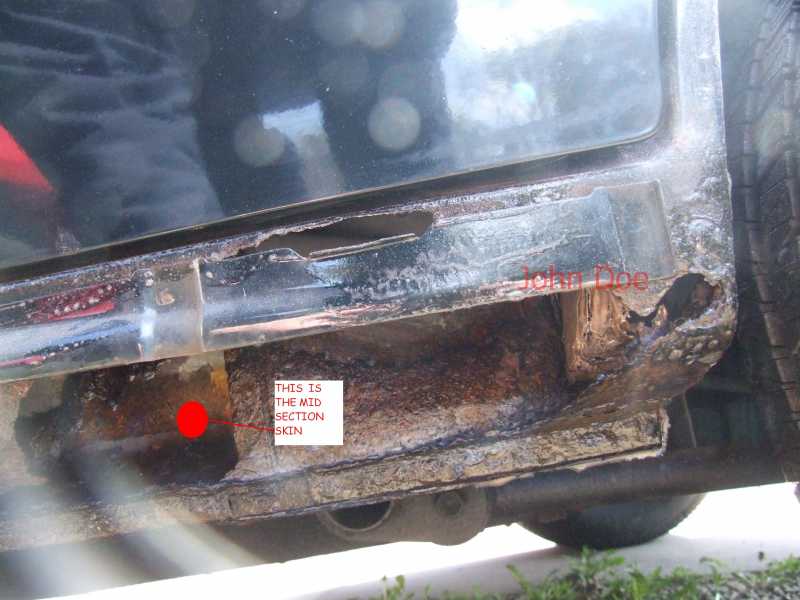

I'm getting ready to drill holes in the sills step region but just as I expected there is another skin inside the sills. I assume it is the same as on the Vitara sill and a cross section would look more like a Ш or Ф than a Ц.
I need to get the Waxoyl on both sides of that skin or the untreated side will continue to rust. I've seen this a few times when years later the sill covers have been taken off Vitaras and the sill has rotted away. You find there is a lot of untreated metal.
Looking down the hole for the step cover clip I can see the centre skin is just inboard. So I am assuming I need to drill at where the red marks are - is that correct?

22 Jun 2013 00:08 - 22 Jun 2013 00:10 #74629 by facade
Replied by facade on topic Waxoyl
I think that there are access holes to the inner box under the carpet. I'll have a look tomorrow.
There is a nasty cavity under the front of the rear seat, the vertical wall is double skinned.
When you get the waxoyl out, remove the seatbelts first!
Both front & back reels live inside the cavities, and will get waxoyl splashes on them, that shows when you pull the belt out. (Guess how I know)
I can't remember how I got it off, likely fairy liquid and warm water.

Holes in the side of the sills would be a blessing.

There are access holes under the edge of the carpet with large plastic bungs in them. ;)

Just been and looked - they look nice and big too so that should give access to the inner side of the sill cavity.
If I open out the middle one of the step cover clip holes I should get access to the outer side of the cavity and reach all the way to the front and to the back. I think I will defo have to do that.
