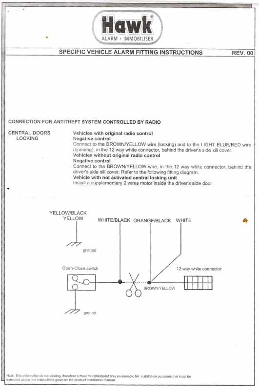

Alarm turned up today, not even going to think about fitting it as I starts nights tonight but the attached files may help someone in the future. Guess they did not have details for an 03 Jimny
