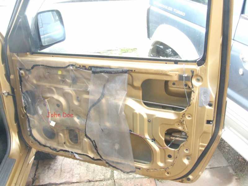

So here we have the door card off.
And a closer look at the door lock unit.

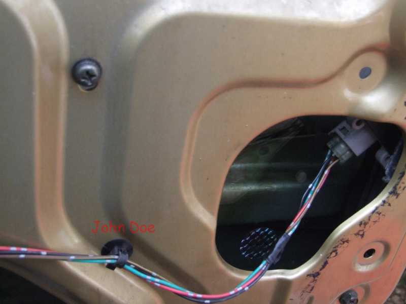

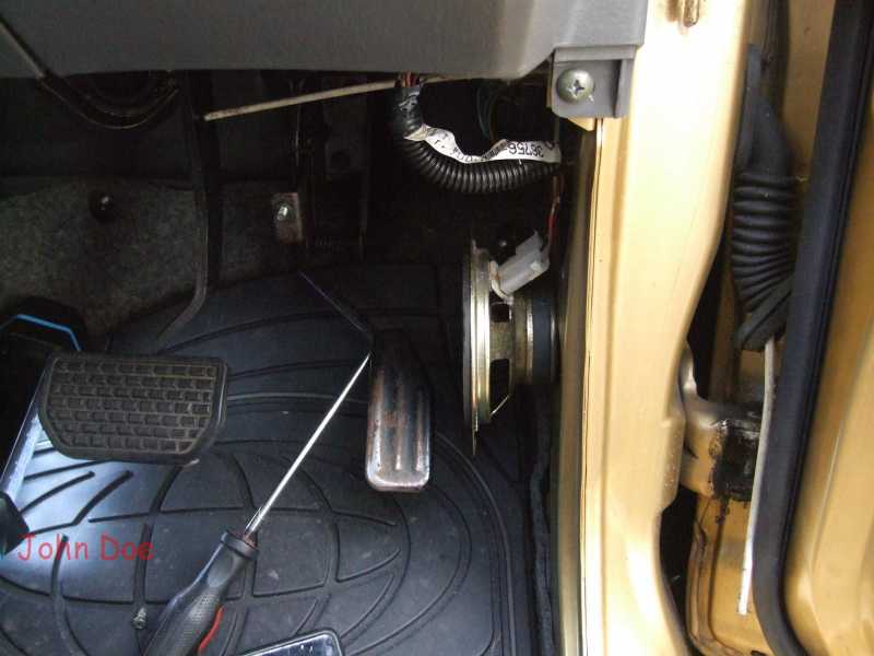

As I decided to add my own solenoid I had to feed the wire for it through the door and I found it easier to remove the speaker to get the wire through. They must employ King Kong to tighten the screws holding the speaker in place"

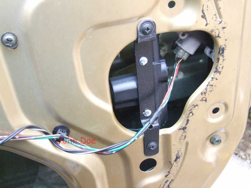

There are not too many places to fit the actuator, you need clearance for the window and a fairly straight run for the rod. I chose this spot as it seemed asking for it.
The solenoid comes with a bendy strip but I broke it when I bent it so I had to fabricate my own bracket. The pic above shows the pre-painted job. I'll add more pics as I get on with the wiring up.

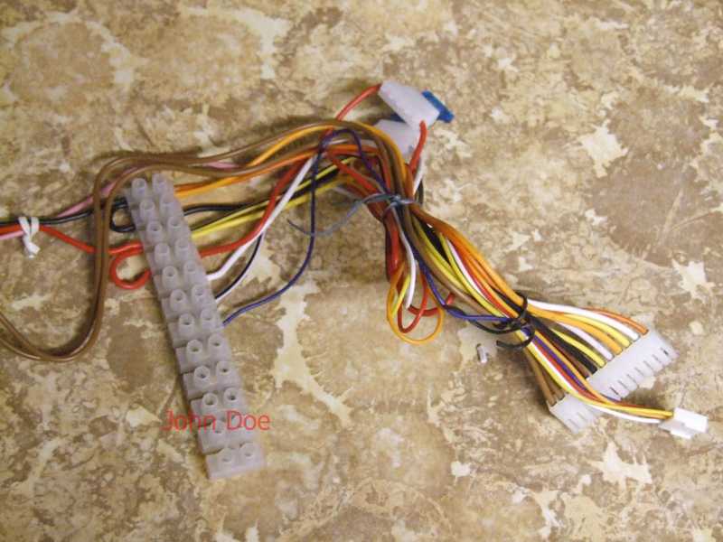

Spent some time while watching Question Time soldering. As the alarm's harness wires were all different lengths, the long wires being too short and the short wires being too long I decided to make them (more or less all) the same length - short,
solder the ends and so on. This dramatically reduced the spaghetti. All wires like power supply etc. being tailored to reach the unit. The exception being the wire to the siren and the wires to the flasher wires I found dangling; these I left uncut to be cut later.
I know some don't like the use of choc block but I have loads of it and I find it to be a great way to connect wires. When I am finished I'll use cable ties instead of the freezer bag ties. :laugh:

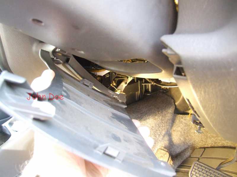

Then I mounted the unit to the unit to the steering column cowling with cable ties and replaced the cover to hide the wiring harness.
The cover is held by two screws and is slid upwards to release it from the upper lugs..

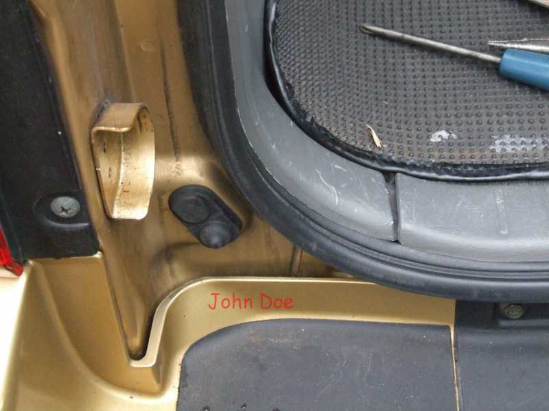

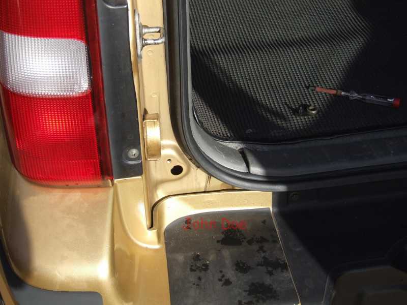

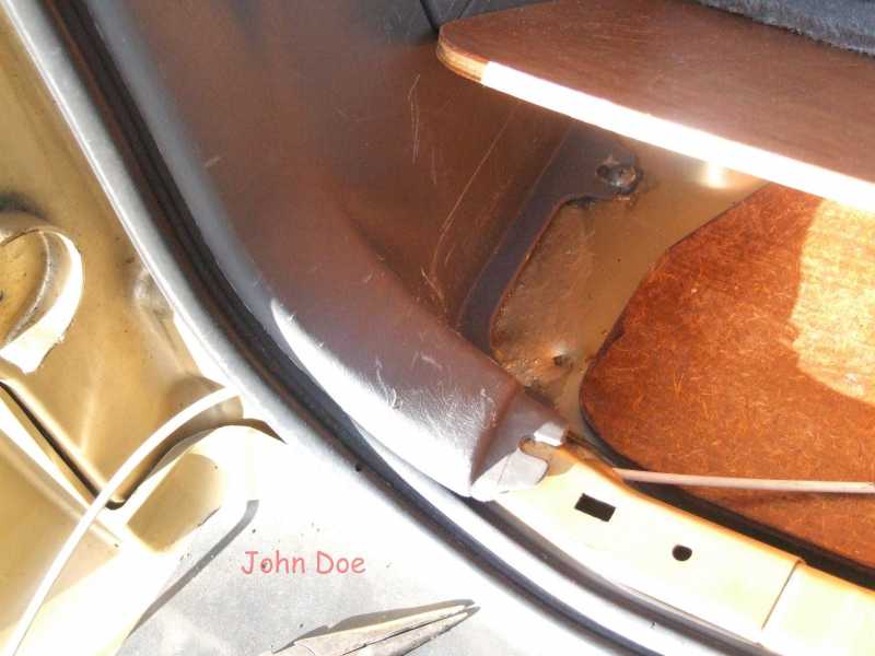

Now for the rear door. It was a choice between that and the bonnet! Thankfully there is a ready made place for a pin switch which uses the same ones as for the front doors. I used the piggy back I had made earlier and abandoned and ran the wire from the front door (but switched to the passenger side) under the trim to the back and passed it through the grommet in the shell.
There is a better grommet farther over to the left which I used rather than the one in this pic.
All I had to do was acquire the switch - my thanks to James for that - and connect up with a spade. I notice they are using speaker size spades more and more. Cheaper by the million I guess.

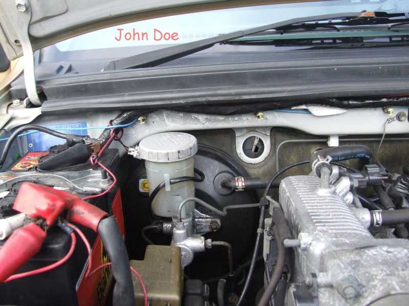

Next is the bonnet pin switch if I bother.
