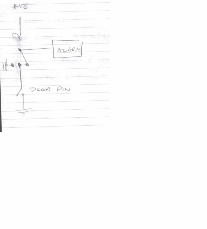

Could you use the courtesy lights switch for your overide,so if the light is off it wont come on when you unlock but if you leave it or doors it will?just a thought may not be possible..
  • helijohn
21 Oct 2013 09:19 #87313 by helijohn
No eBay APP ID and/or Cert ID defined in Kunena configurationReplied by helijohn on topic Fitting my remote central locking/alarm unit
jonesyba420 wrote: Could you use the courtesy lights switch for your overide,so if the light is off it wont come on when you unlock but if you leave it or doors it will?just a thought may not be possible..
Gosh, my brain has just gone into crash mode - super idea.
I had hoped the alarm would be current sensing so if a light came on it would activate it. Not so though. It needs the actual grounding/earthing.
Only two difficulties as I see it. First, and this is a biggie, is it means the CL will be off most of the time and second, I'll need to run a lead into the roof to hook up to the switch or I'll have to locate the hot supply lead to the light and I hate cutting into harness wires.
