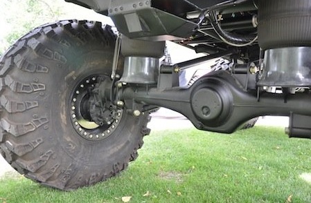

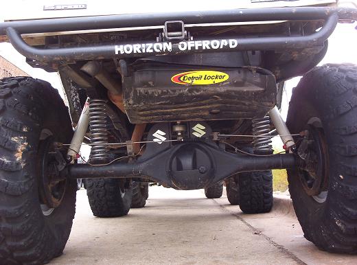

Years ago on the Difflock discussion board there was always talk of the 'virtual lift', basically fitting bigger tyres to get the ground clearance we all seek, by cutting the body away enough to get the bigger tyres in rather that fitting a suspension lift... as Martin's monster truck picture proves, you can put a four foot suspension lift on but you're still limiting your ground clearance by how much room there is under the diffs...
Of course the problem then is gearing... bigger tyres cause gearing issues :ohmy:
Alternatives - portal axles -
or shaving the diffs -
i.e. cutting the bottom of the diff pumpkin and strengthening it...
