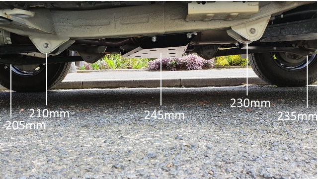

Looking for some help. When reading about body lift and suspension lifts quite a lot of the info states benefit of suspension lift is that it improves ground clearance. But how accurate is this? My understanding is you cannot improve ground clearance without fitting bigger wheels/Tyres to lift the Differential and axles.
So when fitting a 2" suspension lift where do you get the improved ground clearance?
Am I correct in thinking when looking at the pic above all elements identified would be increased by 2" except the low point of the radius arm guards. They might increase a bit as the angle will change but certainly not 2". I have measured various parts ground clearance, see info below. Am I correct in that the parts marked with an * would be lifted but the rest would not?

I have also attached some more pics that show the various measurements. Tape measure was 85 mm in size.

Sorry to contradict but a suspension lift does increase ground clearance under the chassis and body but not under the axles ie diffs, axle tubes and hubs. Bigger diameter tyres will increase clearance under everything as was mentioned. A true 50mm lift will raise the chassis and therefore the body by that amount. Certain fittings ie leading and trailing arms will see no lift at the hubs but the full lift at the chassis joint.

A suspension lift only lifts everything above the axle.

For example my standard gen4 Jimny will happily impact the front bumper, front recovery point, transfer box and chassis end radius arm brackets (specifically the rear axle ones) with the ground off road. But I’m yet to notice a single mark or scrape on the diffs.
A suspension lift would most certainly increase the ground clearance on all of these vital areas that currently hit the ground.
