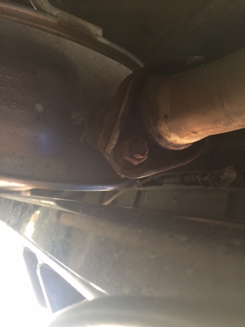

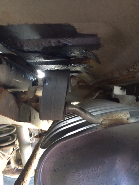

In my opinion you need to get that exhaust fitted correctly before you do anything else !!
It will rattle and wear against the towbar until something gives and the paint on towbars is not thick.
It's definately not hanging right and I think it needs to be pushed forward on the pipe as it seems a bit far back?
You could see if you can loosen the clamp but it'll be rusted well.
If you can find something to tie it up higher (something that won't melt) eg bare wire then just take it to your local exhaust place and see what they say.
If you thought getting the bumper off was a struggle then be prepared for worse if you attempt the exhaust yourself.
I always take mine to an exhaust place as I find that they are not much more than ebay prices and they get to do the swearing :laugh:
It sounds like something has either broken or it has not been fitted correctly in the first place but due to heat/age exhausts will sag over time if not fitted correctly.
From the pic I have just seen the box doesn't look very old so the clamp may loosen but use WD40 etc. and leave to soak in.

Yes, the hangers are like that. In case anyone else considers doing this, I just popped to National Tyres as its only a couple of miles away, and after getting it up on the ramps he advised me there was nothing he could do. He suspects the exhaust is not a suzuki original, and thus the rear box may be a bit larger, and the way it is constructed meant he could not dismantle and put it back any differently. I have a put a rubber O ring under the part that is resting to prevent banging. As its the end box he reckons it wont get hot enough to melt it. When I need a new box, I`ll probably need to source a Suzuki part. I dont know what you guys think of this diagnosis, but when under the car I could see what he meant about being unable to help. Driving there I couldnt hear it rattling, but it is quite tight.

The reason they fit flexible rubber hangers is to allow the exhaust to flex around as it does just that.
If it's not allowed to move chances are eventually the exhaust will shear somewhere with stress.
There are 2 things you could do buy a middle pipe and silencer and get it fitted or DIY .
The other thing is to have a look and see if you can shorten or modify the middle pipe.
It's nothing special just a pipe that possibly you could cut and get a sleeve to rejoin it by either welding or clamping.
It should cost around £60-£70 to replace the exhaust and pipe.
