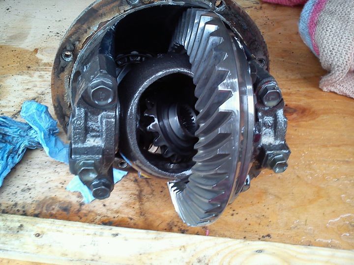

03 Nov 2014 13:33 #128328 by kirkynut
Replied by kirkynut on topic Updated cv s and shafts.
So it seems from what Tom has found the shafts are fine at 22 spline but the diffs may not be, being 2 pin etc, as Supergaz has blown one up.
So a 22 spline standard ARB and 22 spline shafts may be the answer. Still bloody expensive and still needs a diff re built to get the ARB into it, so you may aswell so for the stronger 26 spline set up.
  • TomDK
03 Nov 2014 14:07 #128330 by TomDK
Replied by TomDK on topic Updated cv s and shafts.
This makes little sense Kirky as the diff won't get any stronger going from 22 to 26 splines.
And remember anything can be broken.
Just because one guy breaks his front diff doesn't mean Jimny diffs are generally prone to breaking.
  • supergaz
03 Nov 2014 14:43 #128331 by supergaz
Replied by supergaz on topic Updated cv s and shafts.
It was the pin that sheared. But I can blow anything up :)
