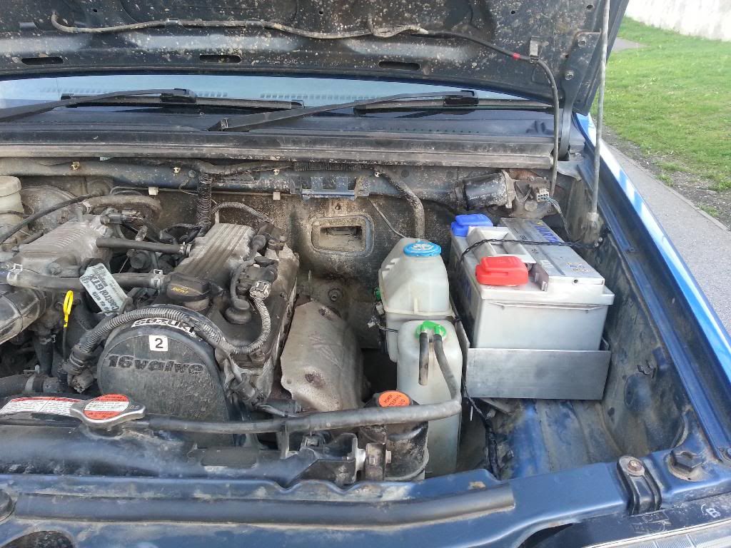

25 Apr 2014 15:16 #113313 by barnes
[IMG
[IMG
could just make a simple second battery tray as I have above and run 2 batteries plenty of room on the passenger side
