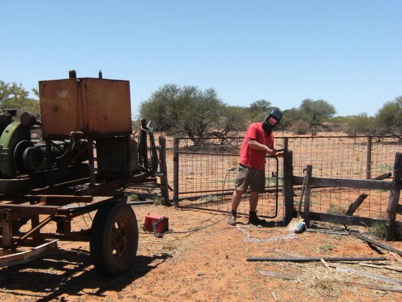

Welders and generators are always a pain. This is me doing some welding in Australia back on 2008.
The welder is a 140amp arc inverter (It's that little red shoebox sized thing on the floor). The generator is that trailer thing on the left. It had a massive old Lister engine that weighed a ton running a generator the size of gas cylinder and I had an old SJ to tow it around with. Anyway, the point in posting this is that when that small welder was turned up to full, the big lister engine would nearly stall. It always amazed me that such a little box of wires could do that!
