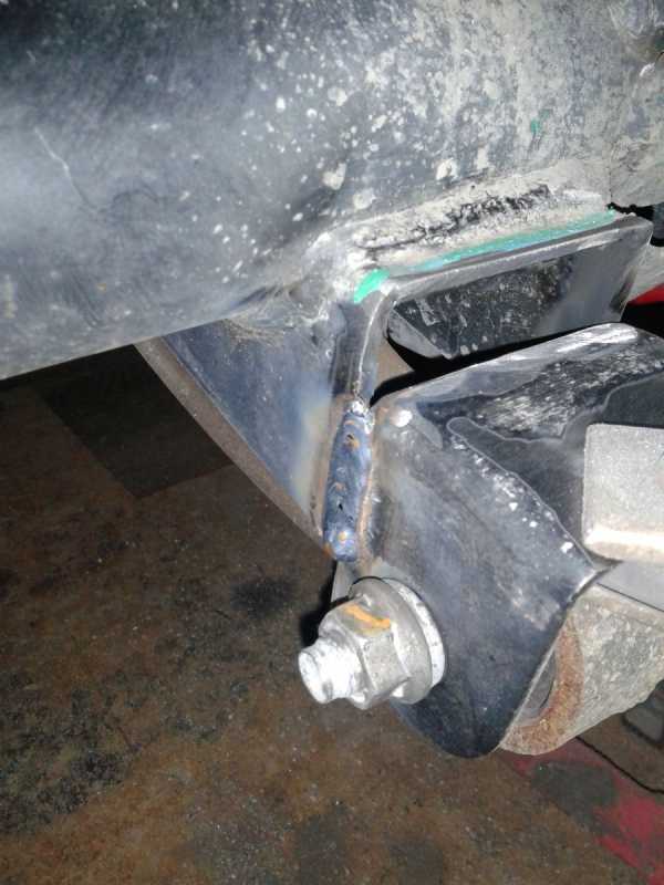

14 Apr 2014 13:25 #112191 by g r e e n
Replied by g r e e n on topic What MIG welder is suitable for car repairs?
GuardianAngel wrote: So any recommendations on a good starter kit?
I am using this
Pretty good welding machine. You could be able to weld suspension mounts and body metal if you need.
