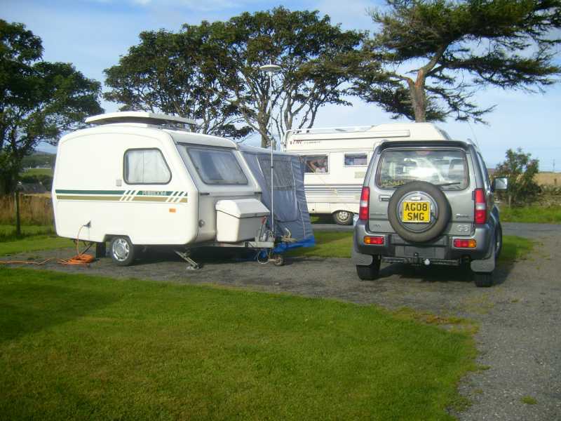

whizz3006 wrote: Good write up, I did exactly the same thing recently but took the bumper off just to make it easier. I also moved my rear number plate because it was obscured by the towball, watch out for getting pulled on that one as per your second last picture. ;)
I fitted my rear number plate on the spare wheel as it was always getting pulled at MOT time.
I bought a waterproof 2 pin connector and a number plate light from ebay and ran the wire through the spare wheel and along the bottom inside edge of the rear door and tapped in to the o/s rear side light.
I suppose if you bought a removable towbar you wouldn't have to bother but I prefer the flange type as you can bolt a lot to them.
I started off high and worked my way down ever since :-)
