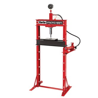

I have never managed to install a new retainer with a tube/pipe or any method other than a press, either borrowed from the local garage or eventually purchased my self. Remember that the retainer is a fundamental part of the mechanism that hold the rear wheel on so has to be a good firm fit.
I bought a press (less than £100) and its been useful for many little pressing requirements from bearings to bushes etc.

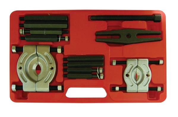

I pulled the bearings off the shafts in my gearbox with one of these, (you might get the wheelbearing off with some extra threaded bar, but I doubt if you could pull the bearing and the abs collar at once.)
and pressed it all back together with one of these (mine is a 10 tonne one), I pressed my wheelbearings back on with it too.
Both useful pieces of kit, but you don't exactly need them everyday

I have a pretty comprehensive set of bearing pullers, lots of big sockets and an anvil so can get most things apart with brute force. When it comes to getting things back together, anything that needs more accuracy/force than I can apply with a big bench vice gets taken up the road to a nearby mechanic with a small press. A press makes it all look very easy.
