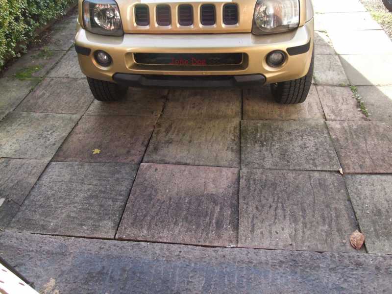

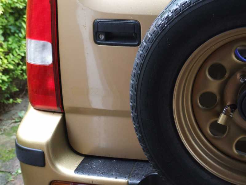

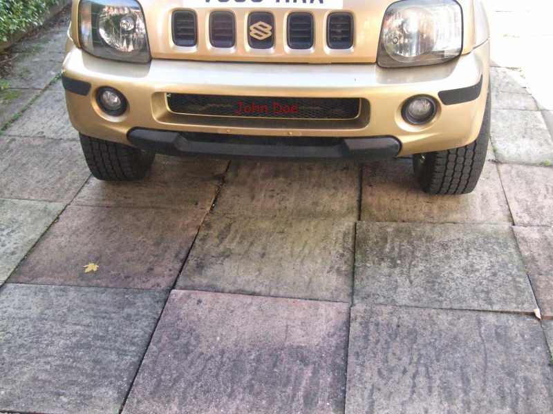

All done.
I used kite line to remove the badges.
It's an old dodge I learned when they started sticking badges on instead of using clips and such. You need something like fishing line, kite string (better cos it is rough) or string used for ceiling light switches would do(like in toilets). By using a length of say 2 feet you can do a sawing motion to cut along behind the badge. keep your hands in close to the car bodywork, you don't want the string pulling on the badge and buckling it. It removes most of the sticky and the badge comes right off in seconds.
Then I used various solvents to shift the gunk (petrol, meth} with the aid of a wooden peg (the tapered end of one half) as a scraper then some Tcut for deep scratches to finish. Some slight imperceptible ghosting is still there. Take a look.
