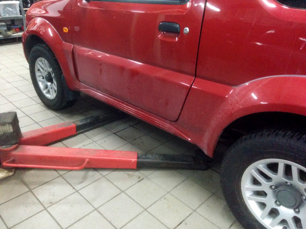

11 Mar 2026 09:49 #263968
by The Coil Spring
Replied by The Coil Spring on topic What did you do to your jimny today?
- CelicaRacer
- Senior Member
- Posts: 52
- Thank you received: 15
11 Mar 2026 10:02 #263969
by CelicaRacer
1999 Suzuki Jimny
1990 Toyota Celica garage queen
1996 BMW e36 touring track car
2007 BMW e61 520d touring
1998 BMW Z3 Drift Car
Replied by CelicaRacer on topic What did you do to your jimny today?
have you tried reversing it?
The ramp I use for every car we reverse in, but in the jimny it needs to be driven in and just works
