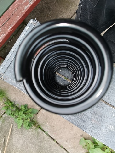

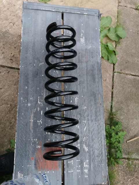

I have seen and removed a few springs
And i would say the one with the smaller coil is not from a jimny

Yes, JackOnlyJack. They look like lift springs in terms of thickness and length. But the one on the Right-hand side is not a Jimny spring. IF the spacer fits into the coil it would fit into the locations but the lift would be more like 3 or 4 inches. Spacer would be acting as an adaptor and dont think it would keep in location for long .

The springs are both the same, it is only that I placed one with the original rubber it came off with and the other with the plastic spacer, which as you say, clearly will not locate into the spring diameter. It looks like I may as well bite the bullet and get the 2" longer springs and have done with it. I am now wondering if the fronts were dodgy, although the spacers did locate into the spring properly but I was not overly happy with the location at the top into the actual chassis housing.

Standard rear springs are 275mm long. Front springs are 343mm long. I'd say you have front springs fitted to the rear.
