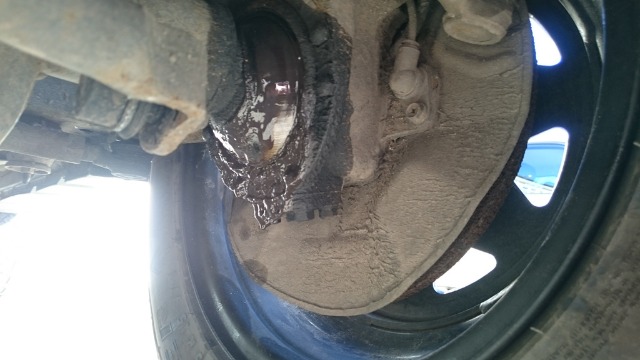

15 Sep 2021 18:55 #238646 by Sean65
Replied by Sean65 on topic Already 2” Springs?
Front all back together. Gentle drive back and forward on the drive and an odd grinding from the front.  More investigation  needed. Great.
  • Dirtbird
15 Sep 2021 19:52 - 15 Sep 2021 19:53 #238651 by Dirtbird
Replied by Dirtbird on topic Already 2” Springs?
That will be the gaurd rubbing off the brake disc the round disc of metal is rubbing on the brake disc
Last edit: 15 Sep 2021 19:53 by Dirtbird.
  • Sean65
15 Sep 2021 20:32 #238653 by Sean65
That’s certainly an option.  It’s something i will check. I generally remove the guards when swapping brakes on my kit car.  They look better too
