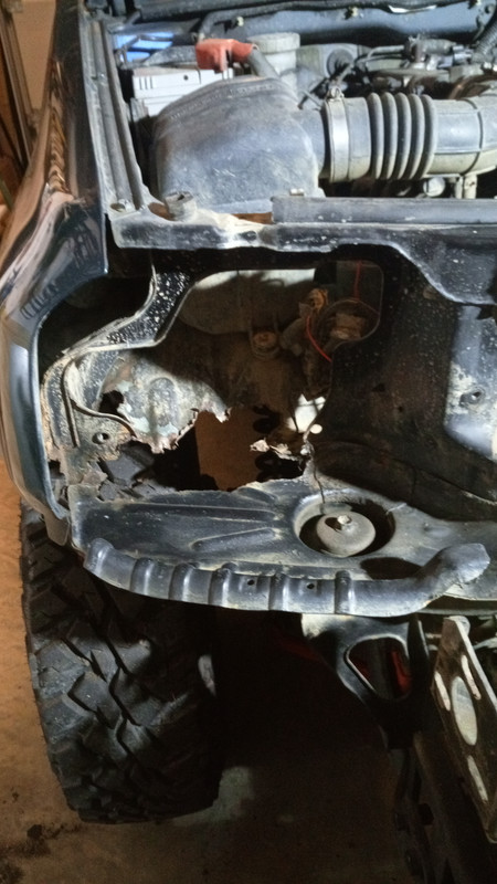

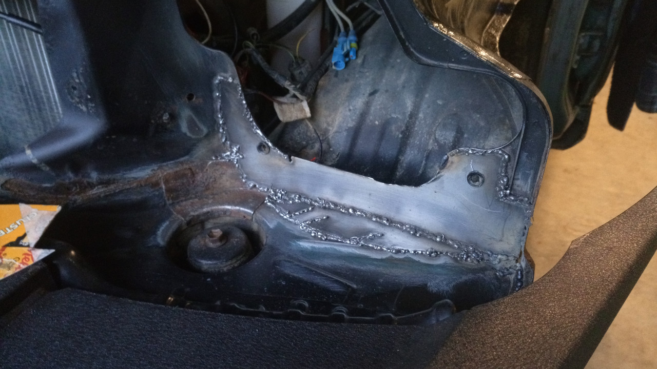

- TillymintDLG
26 Apr 2020 21:28 #221543
by TillymintDLG
Replied by TillymintDLG on topic '05 Corrosion advice Most appreciated....
Your not a Surgeon are you? That's a Fantastic bit of metal surgery there R2!
I've got a 30 yr old Stick Welder that I can do angle iron with but nothing thinner. I think it would be wise to invest in a Mig now? Machine Mart do an TIG/Argon kit for them too! It's going to be a lot cheaper in the long run isn't it?

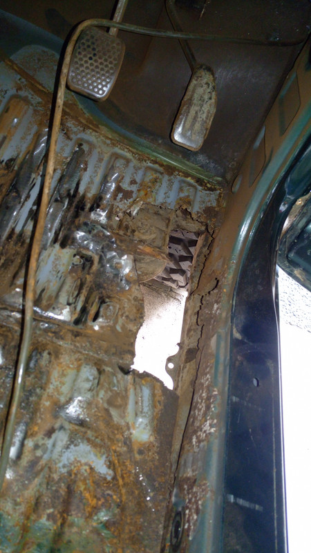

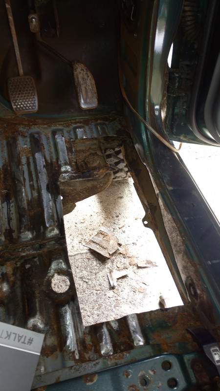

I got away with using my dads 20-year-old Mig welder (It's a Clarke something or other - bought from Machine Mart a long time ago). I didn't use any gas with it, but I'm told it gets a better finish if you do? I will experiment at some point as it has a gas setting. I need to replace the trigger on the welder itself as its a bit broken, so once I get time I'll do that. I don't think you can go wrong having one of these handy - I even replaced the driver's side floor in the car and part of the sill.
