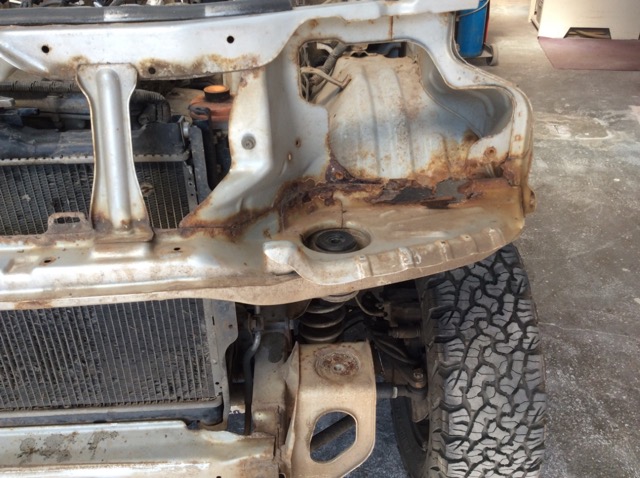

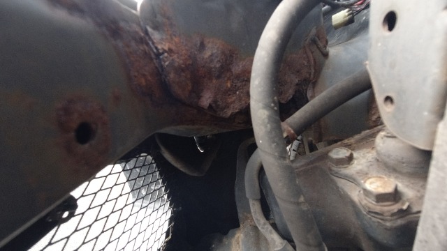

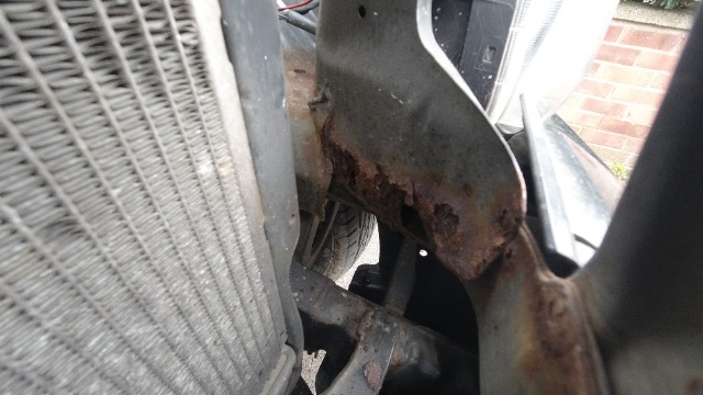

'05 Corrosion advice Most appreciated.... was created by TillymintDLG
26 Apr 2020 16:09 #221530
Replied by jackonlyjack on topic '05 Corrosion advice Most appreciated....
From what you can see i'd say it's repairable
BUT now remove the plastic arch liners and check front body mounts
Then make a decision on whether a front panel would be needed
The following user(s) said Thank You: TillymintDLG
26 Apr 2020 16:39 #221531
by Scimike
Replied by Scimike on topic '05 Corrosion advice Most appreciated....
Totally agree with Jack, get those plastic arch liners off and take a look at the body / chassis mount. I would not be surprised if you find a big pile of for, when you can see rust on the top the mounts below are usually long gone. Can still be repaired, but it's time to fabric the individual parts against cost of a new panel.
Yes it's an MOT fail if they spot it's associated with the chassis mount, but it can be hard to see.
Mike
Mike
