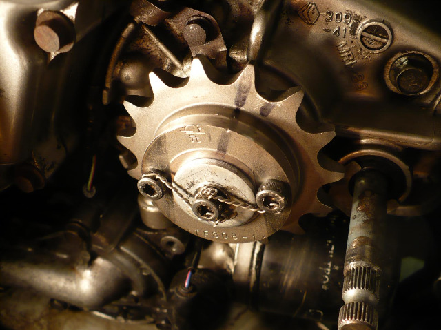

Its an old method, but for critical internal bolts to be very secure, you can't beat good old fashioned wire-locking. (Bolt heads would need to be drilled)
