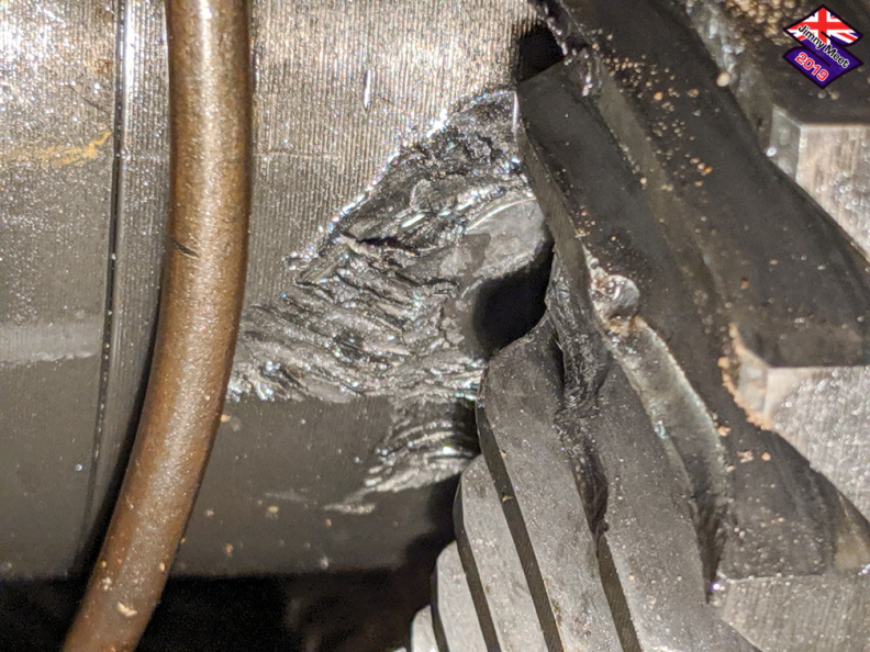

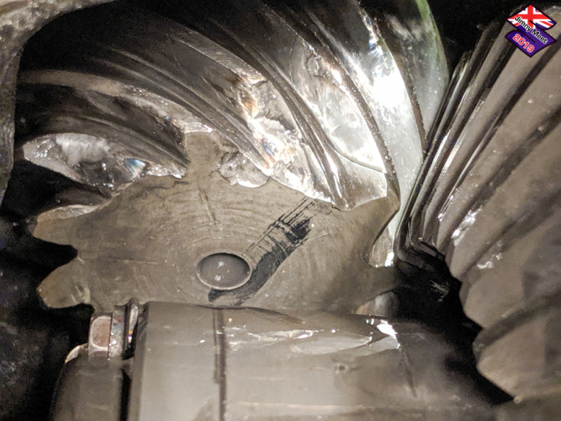

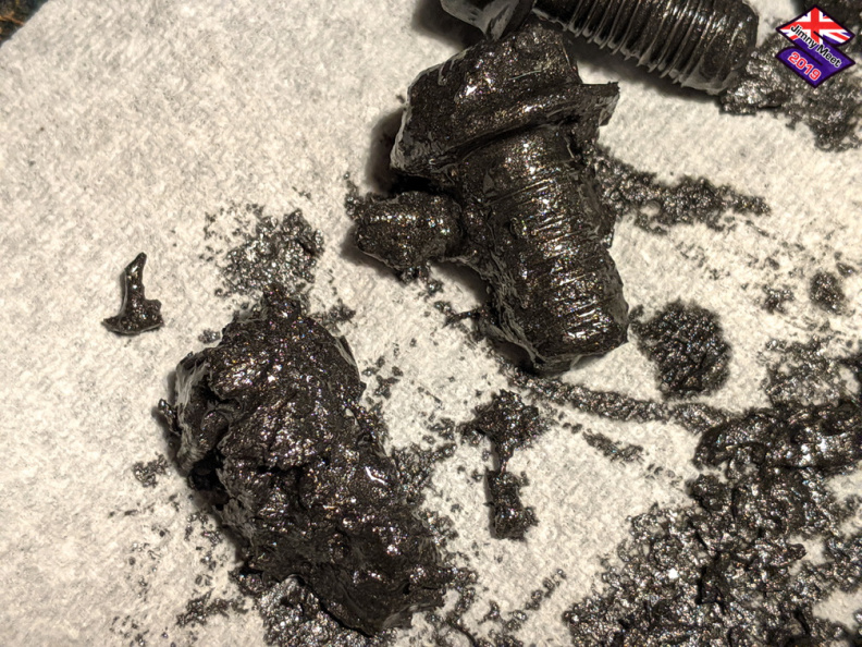

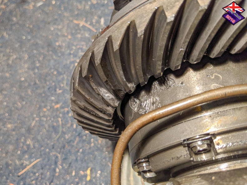

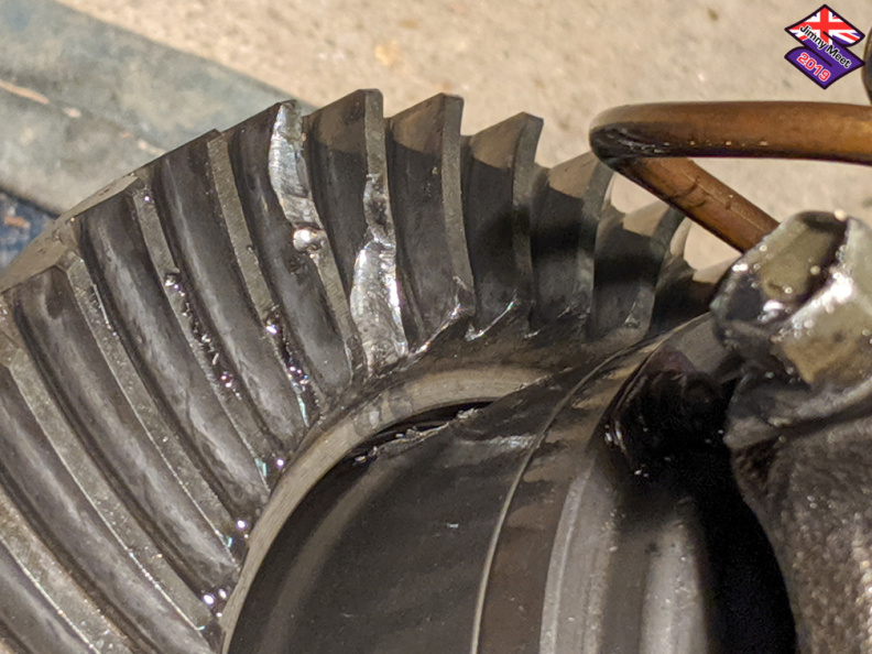

08 Nov 2019 19:52 - 08 Nov 2019 20:14 #215474
Hmmm, not that cool at all!
Here is the damage that I can see.
And here is the real worry, this is a close up of the case of the ARB locker
And here is why, in the bottom of the diff pan are 4.5 bolts! Four are undamaged and the 0.5 is chewed! There is also a large amount of debris
So it is either something in the Diff that has lost its bolts (unlikely as the diff "works") or the bolts were left in there at some point. The axle case was apart for a rebuild in 2013 and I also pulled some parts around at the end of 2018. So whatever way they have been in there a while and it explains the generally noisy diff!.
So the question is whether to rebuild it, or move the ARB to the new Diff from Dave. As the ARB seems to have been damaged it has to come apart. So the initial plan is to put Dave's Diff in so that we have a car for the winter and rebuild the ARB gradually over the Winter.
Thanks for the prompt delivery Dave, that's this weekends work sorted
Replied by mlines on topic Re:Problems with BigJimny!
Reason2doubt wrote: Any chance you could put together a few pictures or even a short video looking through your ARB locker? It would be cool to see it...
