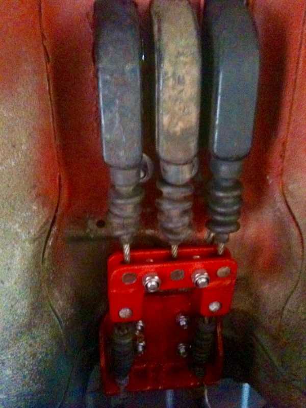

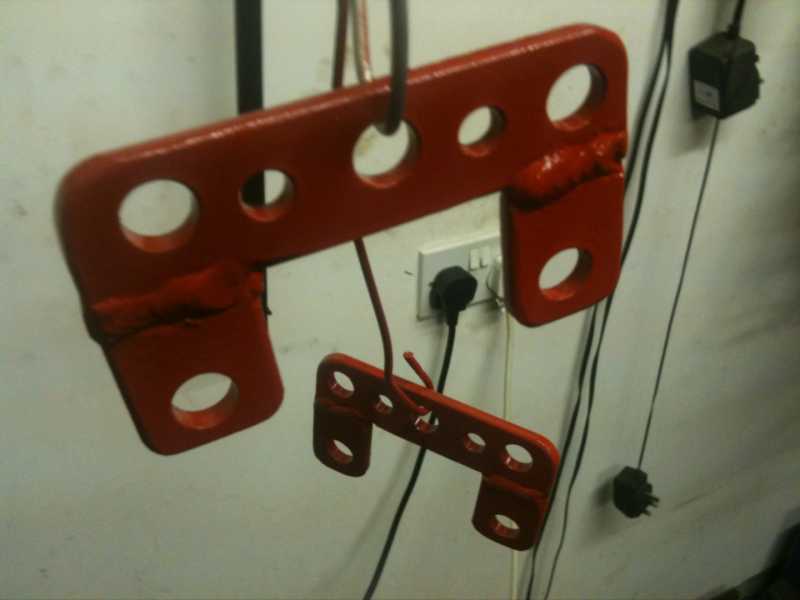

Right back to the start of this thread, yes it's easy to do with the handbrake cables and it works a treat. I just need to cut the original lever handles off and make detachable ones at the right angle. I'll post photos later , they're on my old phone

Thanks Johnniehec - that crossed with my ridiculously-complicated last message, and sounds infinitely simpler! Pictures would be great

Unfortunately, the first three of those photos did not come through. The triple handbrake lever did, and some tantalising shots of brackets, but not the ones that hopefully tie it all together
Nick
