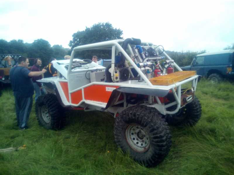

Ask 1066boy what he did, but I'm guessing he either fitted an extra calliper, or modified the existing calliper so the footbrake works one side and the fiddle brake cylinder works the other, and then the transmission brake is the parking brake as normal. (Or he could have just run the fronts off the pedal and had the backs only on the fiddle cylinders and a mechanical link somehow to get all 3 to press with his foot)

Hmm - nice handbrake lever... I can't get a sense of scale from the picture, but 2 of those would look awesome! I haven't looked to see where the brake lines split on the Jimny, to see how much extra piping that is, but that sounds like a good hydraulic solution.
