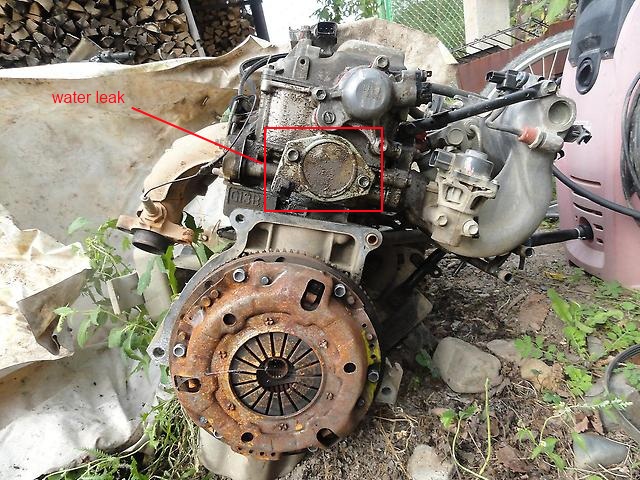

Just to illustrate water leak problem cause(had this fixed a month ago).
One thing to note that this blanking plate is not present in parts catalog(engine scheme) so I was unable to find the cause of the leak until I saw the photo of the engine's back.

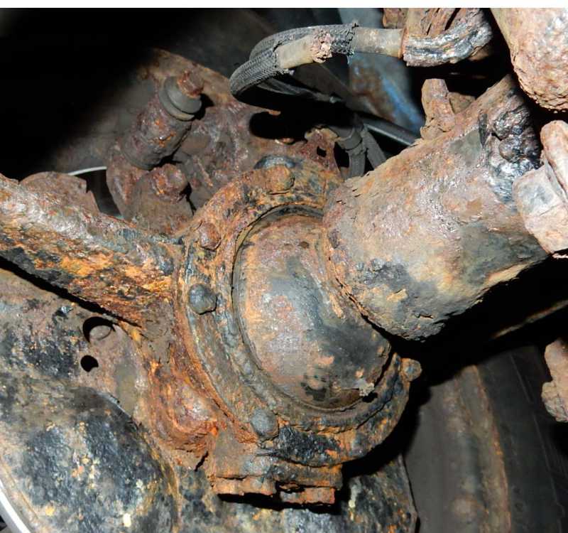

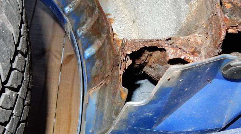

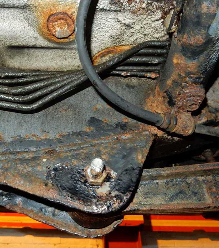

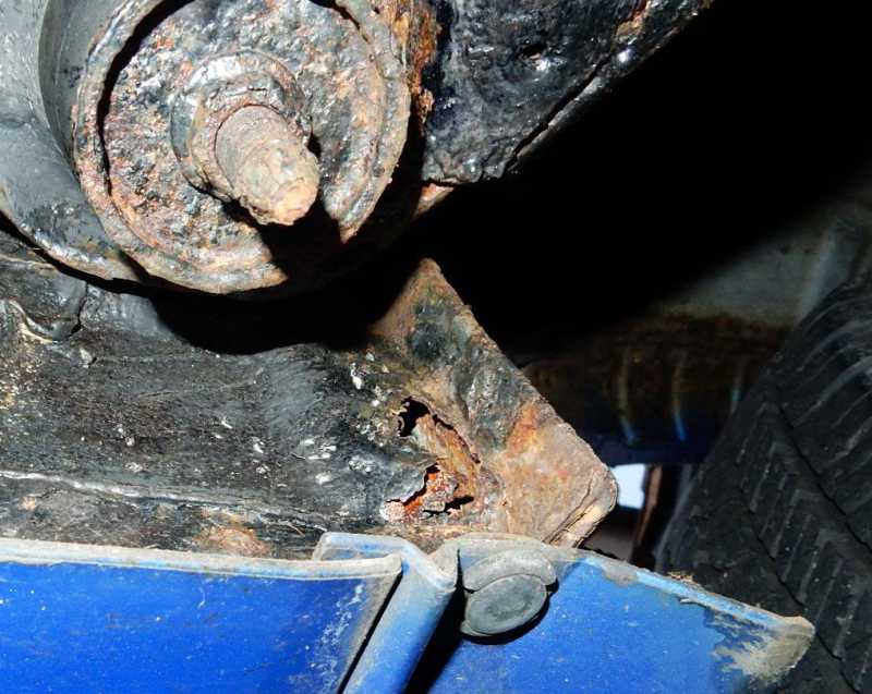

16 Nov 2014 18:44 #129754 by Paul4A
Thanks kindly for the responses so far.
To clarify on the rear bushes, as new bolts did not come with the replacement bushes as was expected (and confirmed with the supplier) at the time, the local garage made do. What I suspect they did was use bolts with the incorrect shoulder - maybe a fully threaded screw or even an imperial bolt. That seems an easy thing to fix as the correct bolts are only about £12 a set. I suspect replacement ones could push the old incorrect ones out.
Thanks for the response on the water leak. Is that an accessible location with the engine in?
I took the car to the local National Tyre Autocentre this afternoon to get a look at the exhaust. It apparently needs a full system including CAT. On e-bay that looks to be around £180. Is there only one type for a 1999 car, just to make sure I get the right one if I go down the route of keeping it.
There is rust to the cills. in fact a surprising amount on the passenger side. Hopefully I can post photos on this forum. Some of them show the sills and some the other parts under discussion - the broken vacuum pipes can also be seen.
On the matter of the front hubs, if we wanted to keep the vacuum system rather than replacing the hubs are the pipes readily available?
Another item I've noticed but one not mentioned by the dealer was a difference between what I'll call the front hubs but that's not the correct name - sorry not have a 4*4 myself and not worked on one. It's the ball on the ends of the front axle's. The one on the drivers side shows that it has turned whereas that on the passenger side has not - it's quite corroded in comparison as well. I'm not sure it's removable / replaceable separately if that's what's needed
Many Thanks again
Paul
1999 T registered Jimny. Early G13BB SOHC engine.
