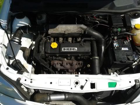

- gaz3359
23 Jun 2014 23:13 - 23 Jun 2014 23:25 #118448
by gaz3359
Replied by gaz3359 on topic Isuzu 1.7 TD conversion
Last edit: 23 Jun 2014 23:25 by gaz3359. Reason: added photo
