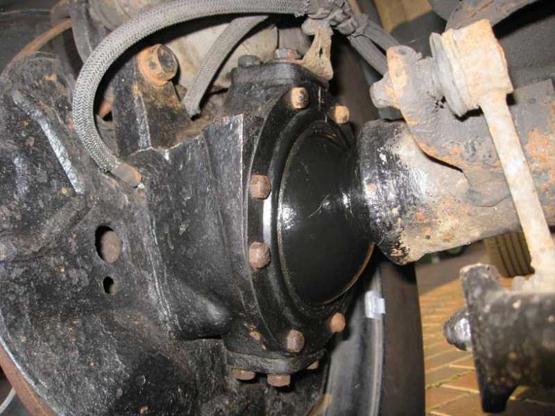

As to the pitting: some people say it isnt a problem, but it makes the dust seal on the hub wear and leak water which wrecks the bearings. Mine looked just like yours, now they look like this:
I had the hubs off to change the swivel bearings, so I used a flapwheel and emery cloth to remove the rust, then gave them two coats of smoothrite (Aldi equivalent actually). Then I waited for them to dry ......
*Yes it is rubbish. It is not water tight, so if you go through a deep puddle you can say goodbye to your swivel bearings, enough water gets in in a normal winter to wreck the lower one. They are not even chromed, so they rust immediately and wreck what little seal there is.
