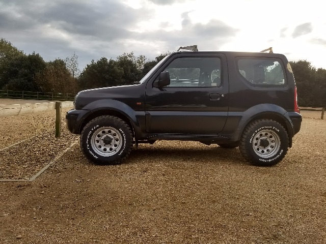

06 Jan 2018 16:07 #188072
by Barry
Replied by Barry on topic Lift Kit shopping list
Just fitted 2" lift and 215x75 BFG MTs. It just rubs on full lock, but only just. Obviously spacers (which is what I wanted to add) would make that worse, so that's put paid to that! The ride is much better (went for 'comfort') but do get the inevitable but mild 'thump-thump' of the tyres at very slow speeds.
