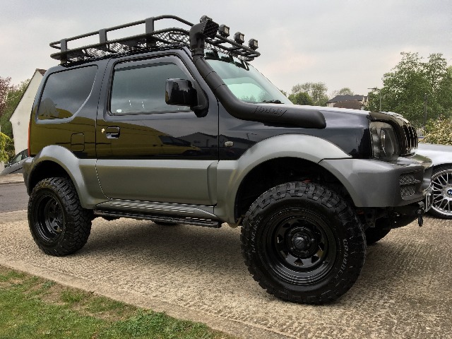

When my wide wheels didn't fit I got a set of old stock steel wheels (for free from cameronmike on here) and had them shotblasted and painted black. It wasn't cheap but the end result is awesome, and I reckon they look better than what I had before.
Busta - that looks awesome. I think if I were to replace my 2004 with a newer Jimny I would do what you have done there. Have you done any other modifications?
