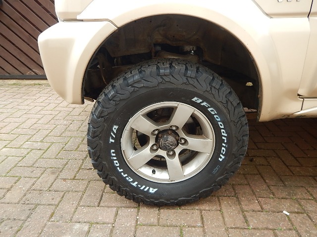

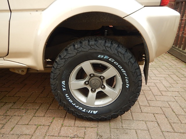

Whoops, missed, tyres are at 23psi as recommended by Suzuki (inside the door slam) but will be adjusted as the tyres are a completely different beast to stock ones...
Happy to report though, at 2" (trailmaster) suspension lift (and 2" bodylift) and 235/75's I have no wobbles, not much vagueness, will be fitting a steering damper soon though, and will have a complete kingpin replacement set of everything ready for the axle teardown to get the replacement diffs in...

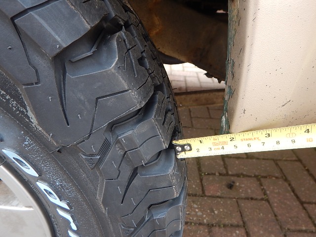

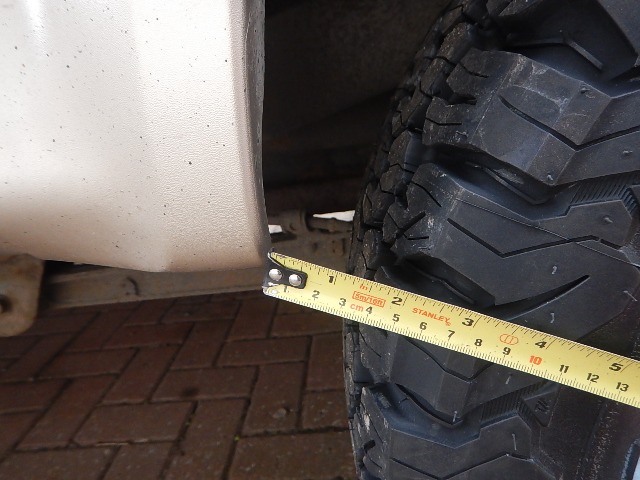

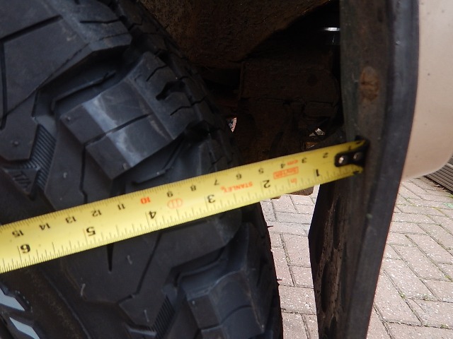

Roughly a couple of inches whilst pointing straight...
Standard alloys, no wheel spacers, 235/75/15 BFGs, 2" trailmaster lift, 2" bodylift

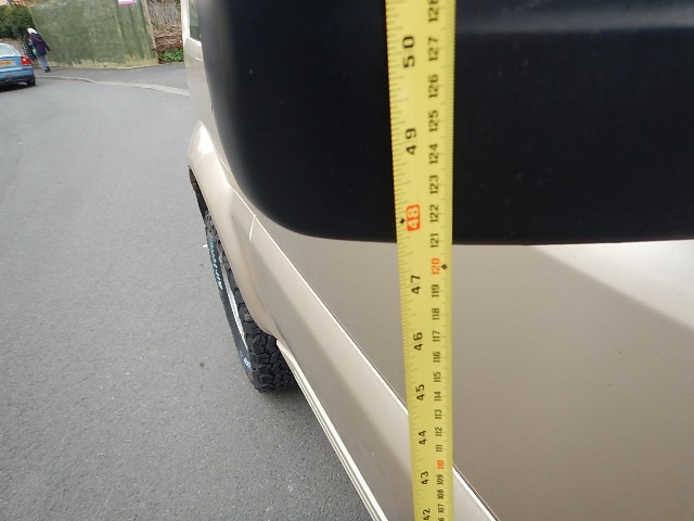

And, comparing the two...
S200KYS = 49" to the bottom of the mirror
BT54VTS = 47.5" to the bottom of the mirror...
S200KYS has a 4" suspension lift, no bodylift and 31"x10.5" tyres
BT54VTS has 29" tyres (235.75/15) so S200KYS has an extra inch there, I suspect the other half an inch difference is the trailmaster kit? Or S200KYS's lift is more than 4"? They are +3" diesel front springs all round with 1.5" spring spacers on the front...
