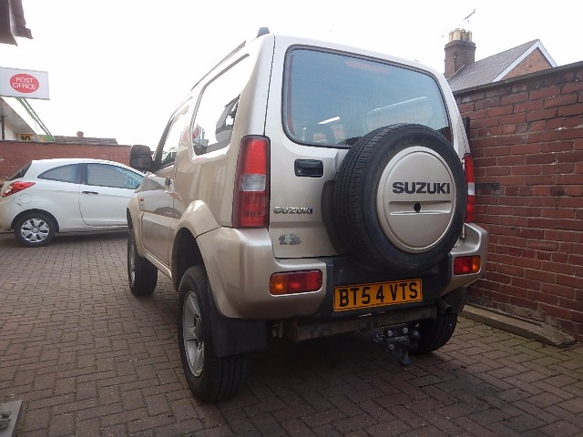

Had a bit of spare time this afternoon, so started on the body lift...
Bumpers off, headlights out, all 8 fixing points wire brushed and WD40'ed, will give pop out from the shop and give them another spray tomorrow, in readiness for completing the bodylift on Sunday
