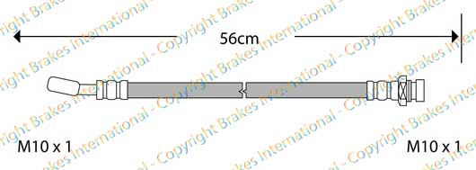

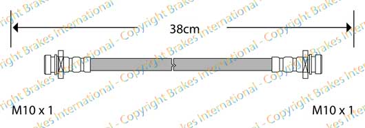

thanks guys for everyone's input, thought I 'd share my findings, conclusions as may be of interest ...
appears as if custom brake line makers can only make S/S braided ones as they don't have capability to make custom standard rubber lines.
from what I've gathered looks like extended Jimny lines are +5 inch (+125mm)
there are only 3 flexible lines .... standard length details below:
front right 560mm
EQUIVALENT TO PARTS: BFH3667, LH6323, BH778145, HOS3206, PHD450
front left 510mm
EQUIVALENT TO PARTS: BFH3666, BH778144, LH6322, HOS3205, PHD431
rear 380mm
EQUIVALENT TO PARTS: BFH3696, BH778347, 51560-81A00, 5156081A00
for S/S lines you can't beat Mr Lines :pinch:
... order going in soon
