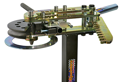

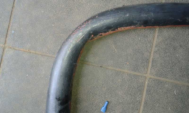

        You need to notch ends where they fit to other tubes what tube bender are you going to use or are you talking about a pipe bender ie a bottle jack and former in a frame ?
top picture is pipe bent in a cheap bending frame as machine mart sell 2nd picture CDS tube bent in a pro bend 105 also tube cannot be bent in the cheap benders pipe can sort of but results vary hugely due to the diffence in quality of the pipe
