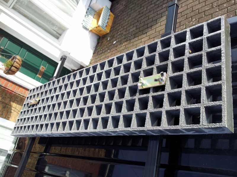

My WB's are about 1.2m ish long and 50mm thick. Got them off eBay for £50 for the pair about a year ago. They are fastened to my roof rack using heavy duty, zinc plated U bolts, but with large wing nuts so I can do them up and undo them by hand easily.
When it comes to using them, make sure you have a shovel to dig the mud out from under the tyres to push them under a bit. The first time I got stuck I didn't, and it took a hell of a job to dig the mud from out of the wheels with my hands to get them under. If you don't, chances are the wheels will just spin on the leading edge and wont get any grip on them.
Also I have since ensured the U bolts are as near to the edge of the roof as possible (more so than the photos below), so I can reach up and undo them without having to clamber up the side of the J to reach.
