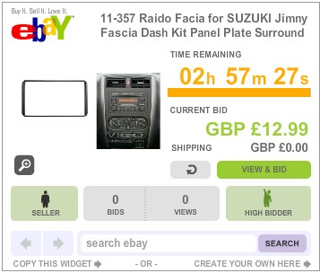

Ok I've given this all thought as was looking to fit a single DIN CD/Radio with a single DIN tray (eventually to replaced with a CB), and have discussed the options below as it may be of use to someone else
1.) the original fascia on a 2005+ double DIN (like mine) has a curved corner hole as below measuring 188mm wide x 103mm deep
2.) the 11-357 Radio Facia for SUZUKI Jimny Fascia Dash Kit Panel Plate Surround Fitting from Hong Kong for £13 simply fits into the original curved fascia (note the curved edges) to create a recess measuring 173mm x 98mm which is the size for 99% of Double DIN car audio head units (such as Pioneer, Alpine, Sony, JVC, Kenwood, Panasonic etc)
3.) Suzuki supply a replacement fascia (73821-76J10-5PK) £40 ish which features a square edged recess that measures 188mm wide x 111mm deep, and when the Pioneer double DIN head unit was available, they supplied a trim panel that took it down to 173 x 98mm.
now I've just measured my single DIN CD/radio at 182mm x 53mm, so it should fit my existing curved edge fascia which is 188mm wide leaving slight gaps at either side but hopefully not leaving a top gap, however that only leaves 103mm - 53mm = 50mm depth to fit a tray (eventually a CB) and typical trays "fronts" measure 188mm by 56mm :ohmy:
but what the hell, I'm going to order one and see what I can do with dremmel :pinch:
will post an update when done :S
