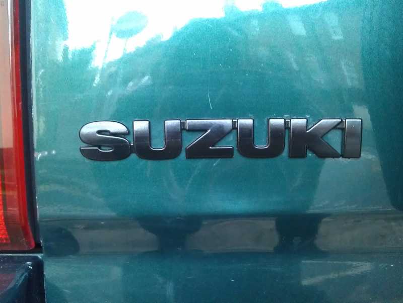

No eBay APP ID and/or Cert ID defined in Kunena configurationRemoved via the use of an old credit card to lift them off by sliding between the logo and door from top to bottom not from side to side.
Cleaned up the gunk left behind with white spirit, but left the faintest of marks to use as a guide to put them back on.
Fix to door with heavy duty clear double sided tape (I say tape it was more like a sticky gunk, very impressed).
www.clasohlson.com/uk/Super-Mounting-Tape/31-1633
Job done

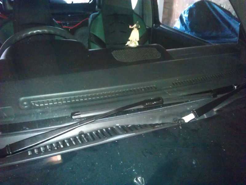

Got the blades for a good price from eBay:
