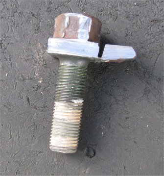

Oh what fun I had
Just cut the flanges off the bolt and it comes undone with your fingers.
The crank is about 3mm short of the pulley, so you won't touch it with the cutter.
A new bolt is about £10
