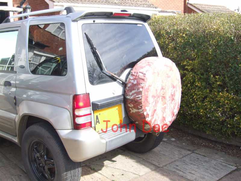

I'll try that, I did put tape on the door catch with no luck but according to my assistant the sound is defo coming from the hinge side. I even thought it might be the petrol flap but this noise is heavier sounding. It is just like an exhaust pipe catching the chassis.

Now then, if this is caused by the door hinges having very slight vertical play how can I check it without resorting to door removal?

Great suggestions. I can strap a strap to the door but then:
1. I don't have a towbar
2. The rear roof spoiler might prevent a strap going to the roof rails.
