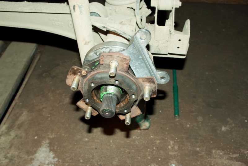

Nice! Interesting solution. Can you tell more about rear disc brakes? From which car solution to fit on Jimny axle. Because I see that you have a emergency brake is not hydraulic.
- g r e e n
24 Oct 2013 03:06 #87689
by g r e e n
Replied by g r e e n on topic Suzuki Jimny on air suspension
I swapped rear axle to full floater. Did you see design of rear axle TLC80? My Jimny has same.
I made custom rear half-shafts, mounting for spindle and calliper. All other parts are original Suzuki except brake calliper.
This mod gives you rear disc brakes, removes weak rear half-shaft bearing which dies after first crossing river, and emergency brake which really works.
At first time I used callipers from Honda Accord but later I found Golf IV rear callipers. They are smaller and requiring less work to do.
