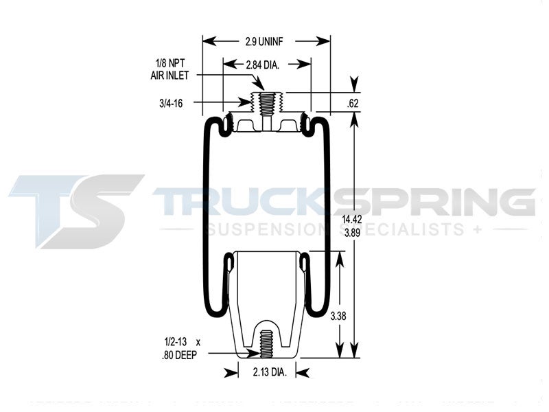

I chose these airbags by their size (min/max height, diameter etc). As I remember Firestone does not have much choice in range of Firestone sleeve type airbags.
Can you give me parameters of 7000?

05 Apr 2014 12:26 #111313 by Busta
7012:
9004:
The 9004 has more travel (14 inches vs 10.5 inches) and is a lot bigger, so I guess the ride is firmer? Do the bags ever reach full extension?

05 Apr 2014 12:43 #111314 by g r e e n
Replied by g r e e n on topic Suzuki Jimny on air suspension
7012s are too short for my Jimny. I fitted such airbags for Jimny with about 2-3" susp lift.
9004 looks completely different than mine.
Try to find in original Firestone catalogue airbag with partno W26-358-9004.
And yes it's firm on big bumps. To make it smoother I added extra tanks for each airspring. Then I found solution how to make piston with same shape as 7012.

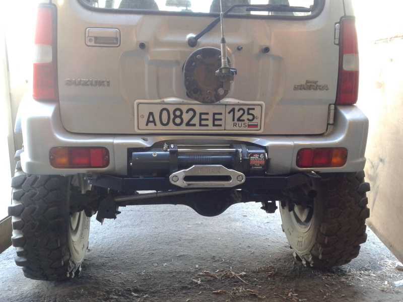

Replied by g r e e n on topic Behind winch
Just to avoid long walks for help when I roll without friends behind or to help friends behind if they don't have a winch B)

  • jonesyba420
15 Apr 2014 11:42 #112252 by jonesyba420
Replied by jonesyba420 on topic Behind winch
nicely done B)
